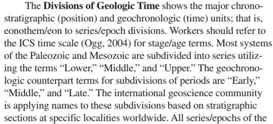

Tu es un peu dur avec Gaeldeploeg. Une partie de la réponse en chiffre ici :
"The Early Cretaceous Jehol Biota in China has produced numerous well preserved fossils of feathered theropods and early birds. Recent discoveries of feathered dinosaurs, as well as transitional pterosaurs and a sexually mature individual of Darwinopterus preserved together with an egg from the Daohugou Biota of an earlier age than the Jehol Biota, in northeastern China, have greatly enriched our knowledge of the transition from dinosaurs to birds and primitive to derived pterosaurs. The age estimate of fossils or host strata, however, has proven to be contentious and varies widely from the Middle Jurassic to the Early Cretaceous. Here, we report a SHRIMP U–Pb zircon date unambiguously associated with the fossil horizons, and thus, for the first time, provide an age calibration for the earliest appearance of feathered dinosaurs and transitional pterosaurs. Date results indicate that the feathered dinosaurs of China were present more than 161 Ma ago, unquestionably older than Archaeopteryx in Germany, and are the earliest known feathered dinosaurs in the world. Furthermore, feathers appeared in ornithischians before 159 Ma rather than late in the Early Cretaceous. The known transitional pterosaurs first emerged before 161 Ma. The Daohugou Biota, containing mammals, primitive pterosaurs, insects and plants, in addition to the feathered dinosaurs, was living in Inner Mongolia ,western Liaoning and northern Hebei in northeastern China during the Middle Jurassic."
Deuxième réponse hors-sujet. Décidément, écrirais-je un trop mauvais français pour être compréhensible ?
Mon interrogation était donc : comment peut-on traduire « A true carinate bird from lower Cretaceous deposits in Mongolia and other evidence of early Cretaceous birds in Asia » en langue française.
Invité jean francois06
Posté(e) (modifié)

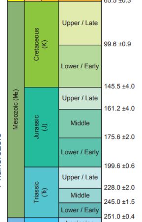

il y a 25 minutes, Drealiste a dit :
Tu es tout aussi dur avec moi. En effet je ne traduis pas mais je donne des pistes pour la traduction early cretaceous --->geochronologie, et lower ----> biostratigraphie, chronostratigraphie.
Cette nuance  n'existe pas chez nous (age absolu, age relatif). Du coup la traduction avec ces nuances n'existent pas. Crétacé inf. pour les deux, si je ne me trompe pas.
Modifié par jean francois06

il y a 28 minutes, jean francois06 a dit :
Allez: Crétacé inf et Crétacé basal
