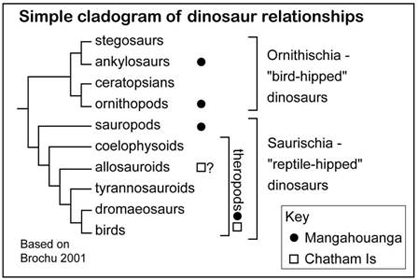

New Zealand dinosaur fossils are known from three localities, and are about 145, 75 and 65 million years old. Although dinosaurs lived exclusively on land, it is interesting to note that fossils have been unearthed from shallow sea sediments, not terrestrial (lake or river) sediments.
The 75-million-year-old dinosaurs are about 10 million years younger than the separation of Zealandia from Gondwana. Over 10 million years of isolation they must have evolved considerably from their original Gondwanan ancestors, making them distinctly Zealandian dinosaurs. Only fragmentary bone fossils have been found, so the detailed identity of these dinosaurs remains obscure.
Sauropods and theropods
New Zealand’s first dinosaur fossil was found by Joan Wiffen and her friends in the late 1970s. Identification of this first find, the tail vertebra of a theropod dinosaur, was confirmed in 1980 by Australian vertebrate paleontologist Ralph Molnar. After that, Joan Wiffen found other bones which showed that 75 million years ago a community of dinosaurs existed including sauropods, a theropod and armoured dinosaurs. At least six different species have been discovered in the Mangahouanga Stream, inland Hawke’s Bay.

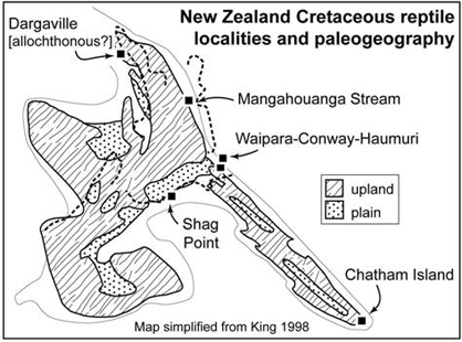

Sans titre.jpgLe gisement de dinosaure de New Zealand.:siffler:C'est pas la profusion de dinos, par contre en reptile marin a long cou=>kaiwhekea katiki

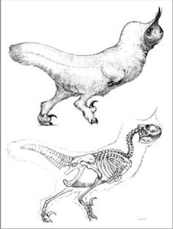

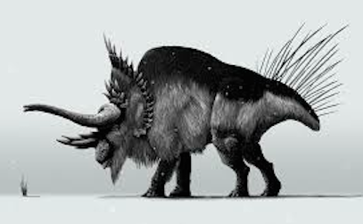

Au Crétacé, la New Zealand était dans le cercle polaire, il y avait une nuit polaire, une baisse des températures, Des études isotopiques de l'oxygène donnent une température annuelle moyenne de -2 ° +/- 5 ° Celsius et un arrêt de la production végétale et observable sur les ligne de croissance des tronc fossile .
La flore, Les fossiles donne l'image d'un environnement forestier polaire mais bien végétalisé sans équivalent actuel, dominé par des fougères, des gingko et des conifères,
 Il est envisager que certains dinosaures du godwana migrer, que d'autre hiberné comme le timimus  ou creusaient des terriers( dinosaur polar.). Il y a beaucoup plus de chose en Australie.

Harfang.pngUn Theropode en mode Harfang:wub:
ceratopcien.pngUn Ceratopsien des neige:vache:
