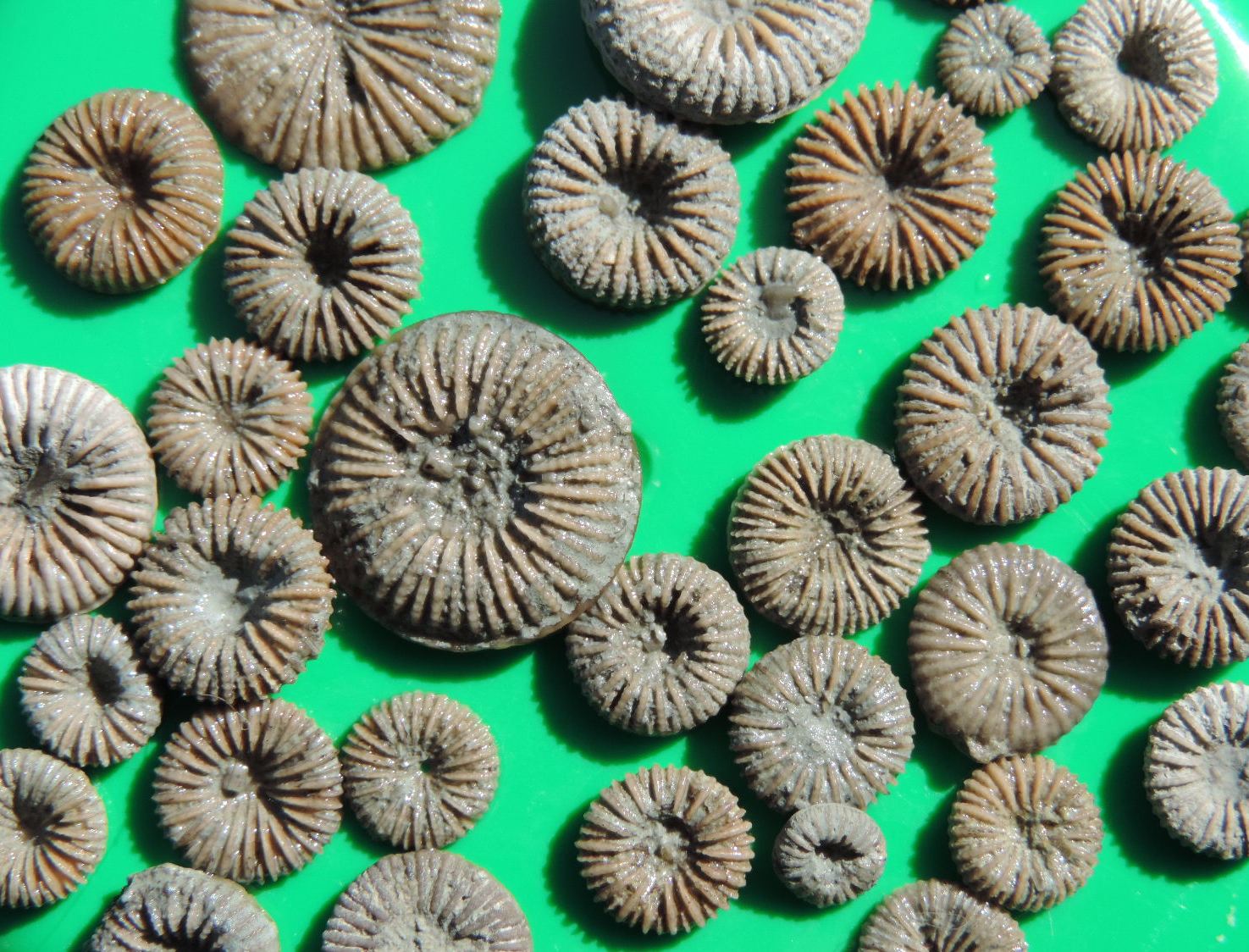

Encore un chouchou....j'adore récolter ces petits coraux rugueux du Llandovery sup, Silurien inf  , Gotland  0.4 à 3 cm
Paleocyclus porpita

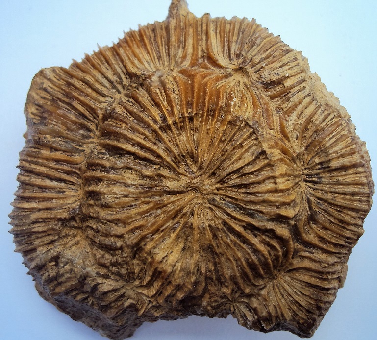

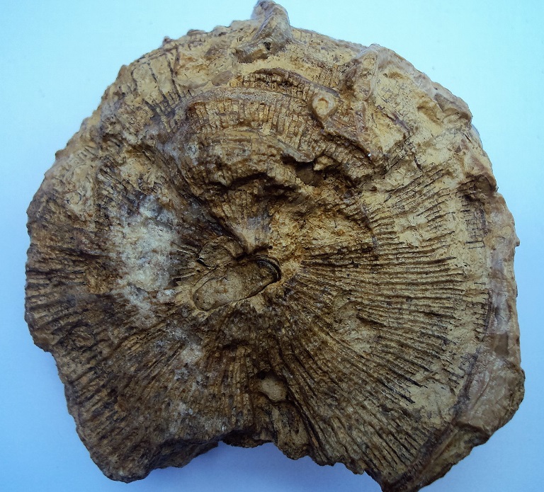

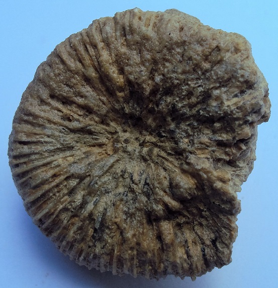

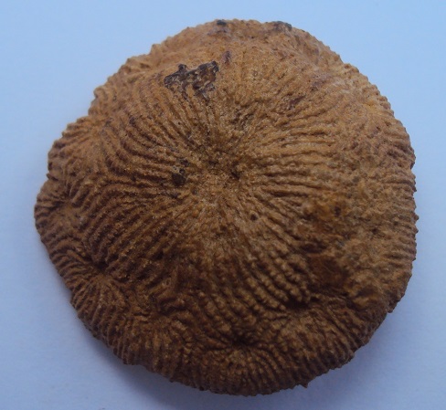

Bonjour a toutes et a tous.

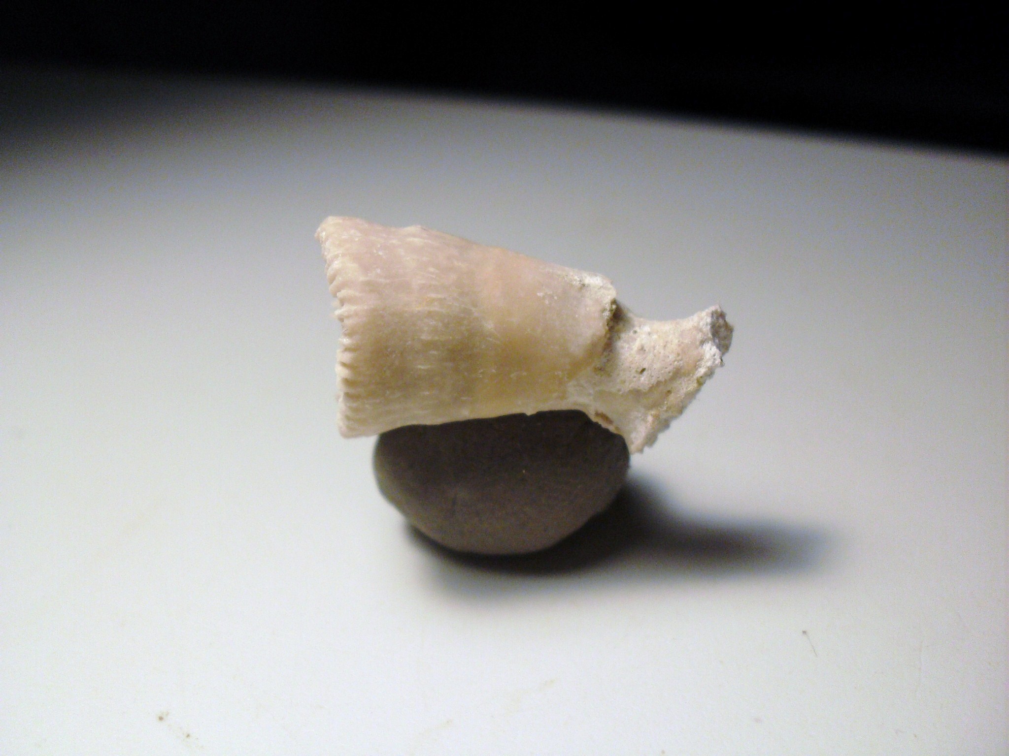

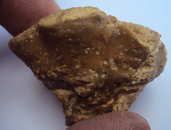

une petite série de l'Yonne (hauterivien) le dégagement de certains ne sont pas finis...
1:
2:
3:
4:
5:
6:
7:
8:
9:
10:
d'autres suivront!!
si vous avez des noms pour certains d'entre eux je suis preneur... merci d'avance.

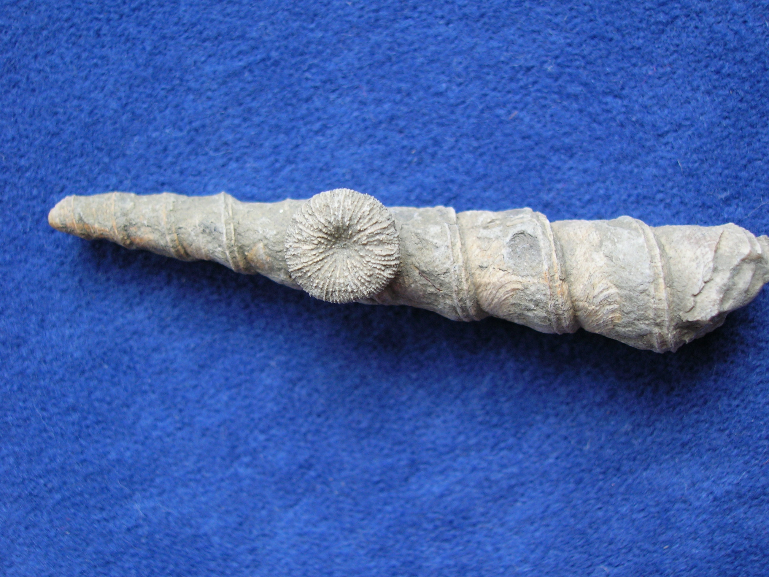

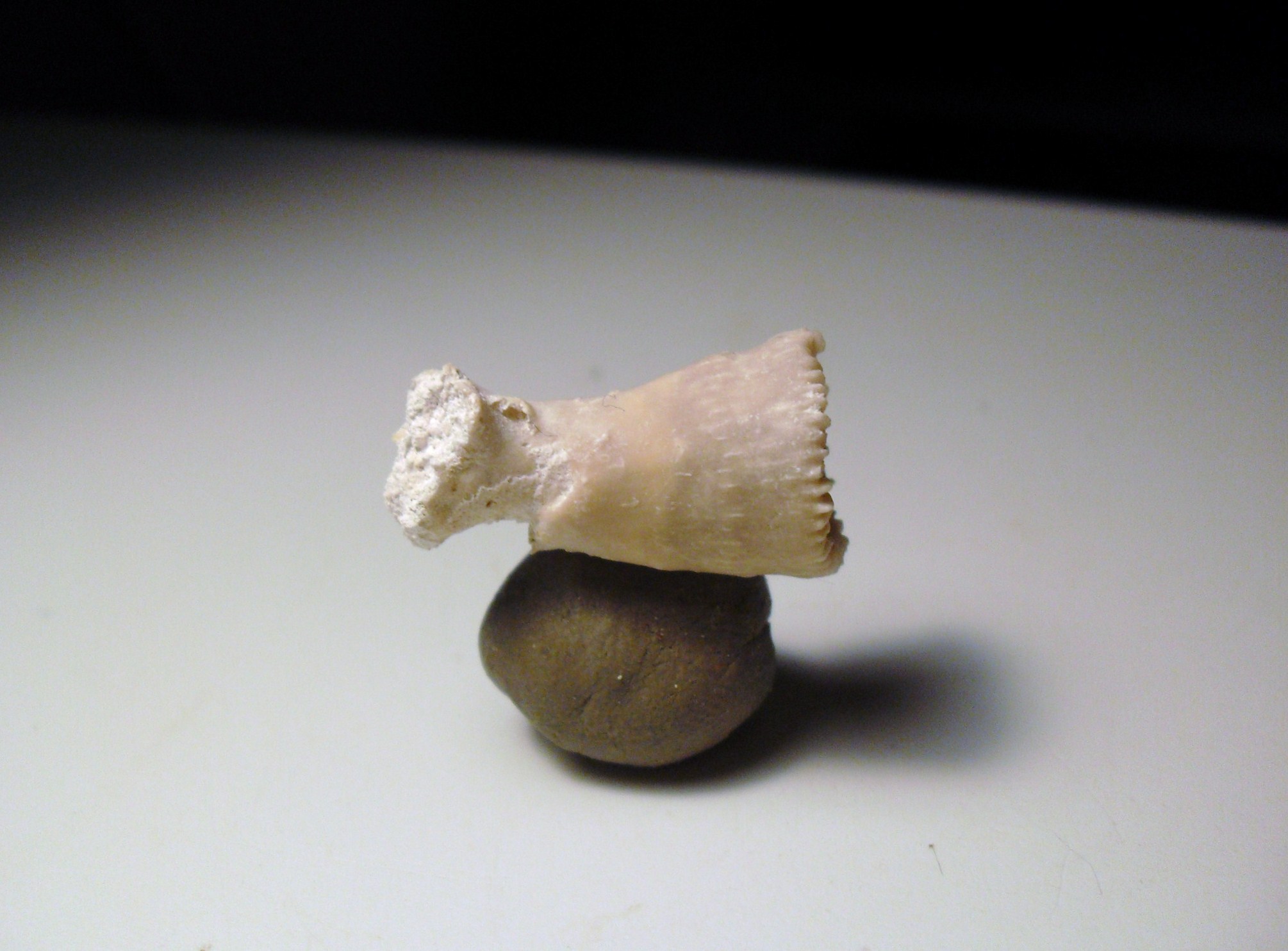

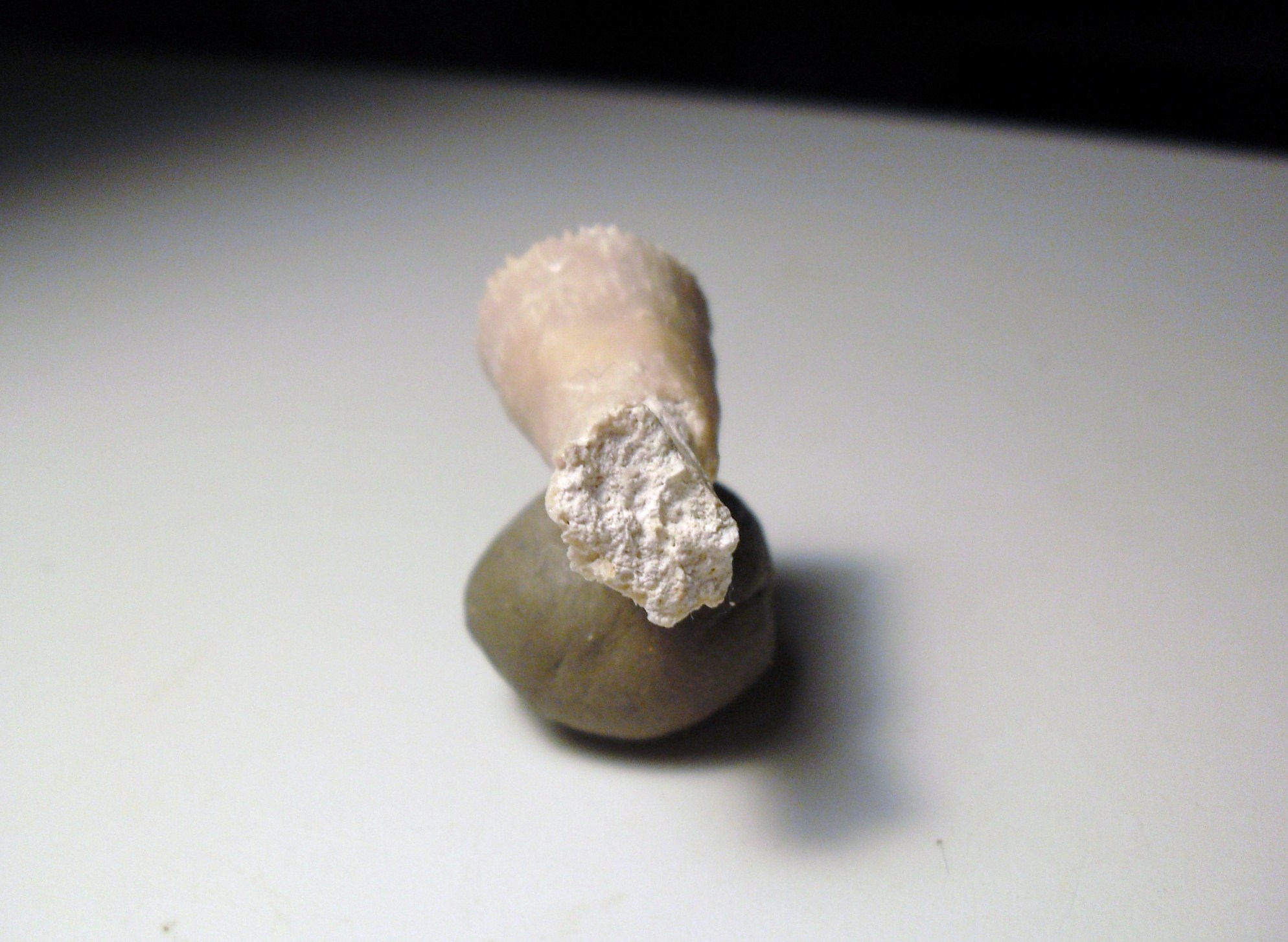

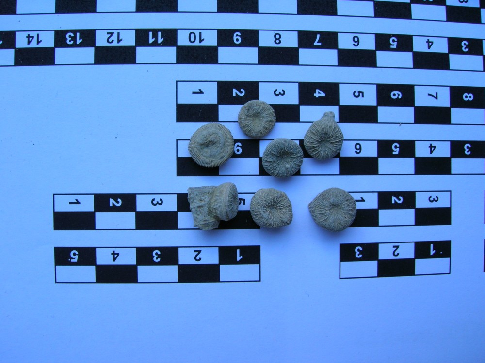

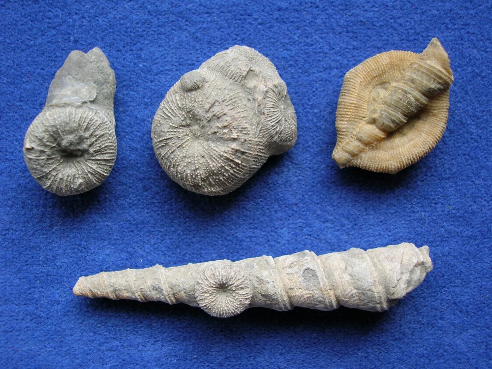

Lo prometido, pequeños Rhizangia brauni (Michelin 1846). Ilerdiense, la mayor parte de los ejemplares, salvo los agarrados al Tympanotonos que provienen del Thanetiense.

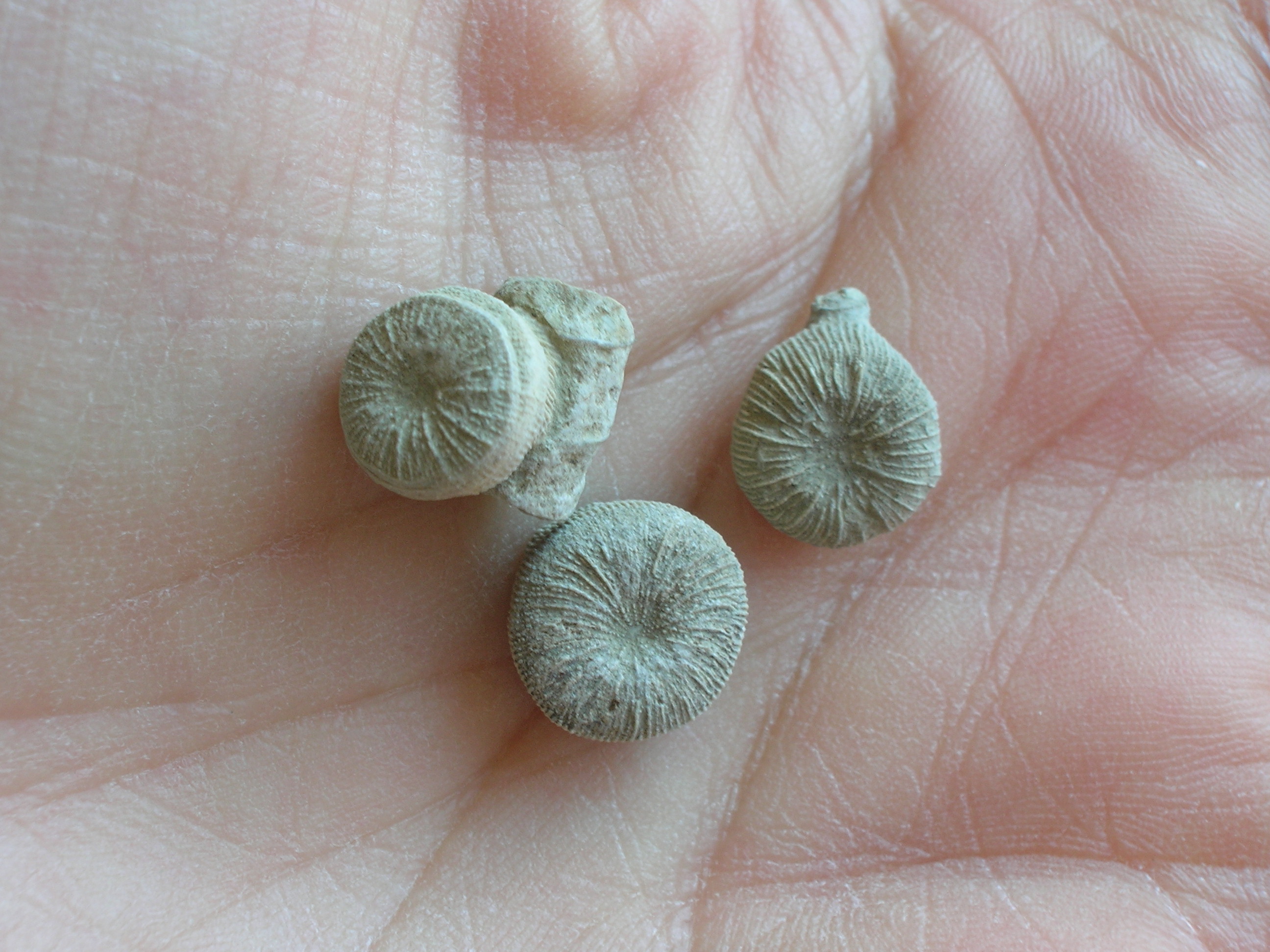

Y ya que estamos, más pequeñines. Sphenotrochus ¿faudonensis (Barta 1973) Bartoniense. Unos 25 entran de sobra en la palma de la mano.
Le 10/6/2017 à 12:29, warrior45 a dit :
1:
2:
3:
4:
5:
6:
7:
8:
9:
10:
d'autres suivront!!
Y para Warrior45, muy bonitos ejemplares, e interesantes.
Los números 4 y 6 son Dimorphocoeniopsis beauvaisorum (Zlatarski 1967), interesantes ejemplares.
El resto tengo que buscarlos, alguno más seguro que puedo identificar.
Saludos

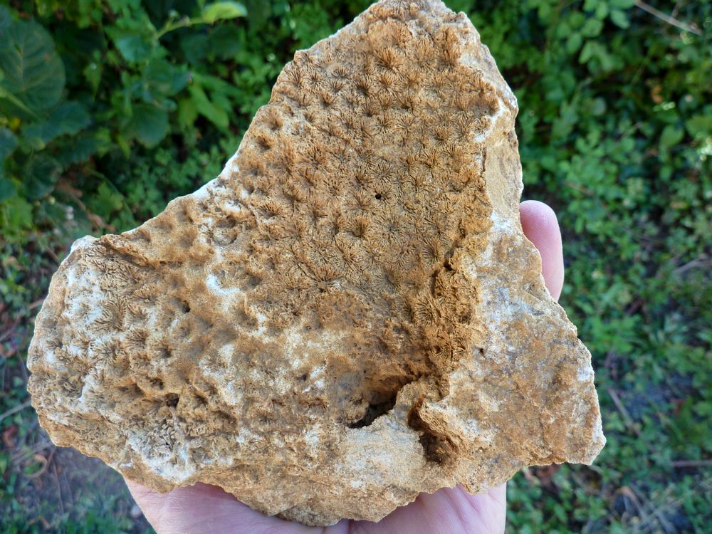

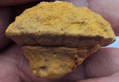

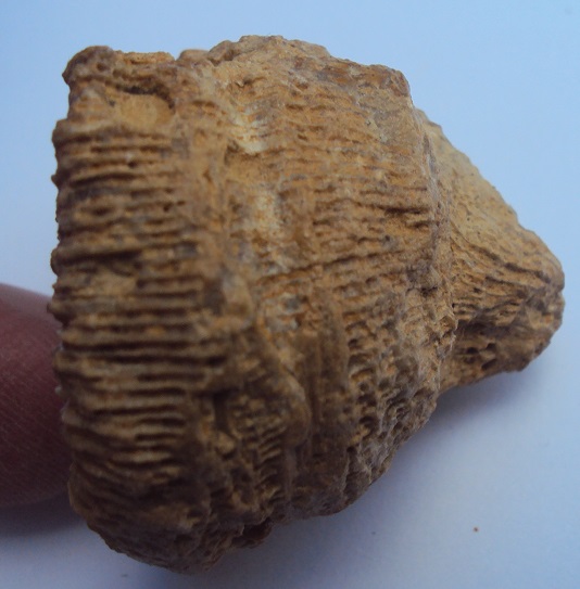

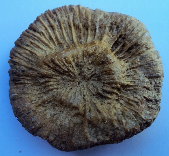

Difficult to identify. Thamnasteriod coral, very common design. It´s necessary to see thin sections. At least polished sections.
As you said, it may be Thamnasteria. Or as he told you, Dimorpharaea. Stephanastrea with thamnasteroid appearance, even.
I recommend to you Lathuiliere B. 2000 Coraux constructeurs du Bajocien Inf. de France Part1 et 2. Geobios.
If you don´t have it I can send it by mail. I don´t have links.
With that documentation and the specific location, Nievre is too broad, perhaps you can adjust it.
Thank you very much Oyo. :super:
I already have the document by Bernard Lathuiliere. I wanted to know if it's Thamnasteria or another.
For my first specimens I was not certain of the floor but for this harvested in St Benin des Bois I am sure that it is Bajocian inferior.
As I have already said it is impossible to differentiate these genres with the naked eye.
Thin sections are required.
As can be seen in the articles I cite, the differences between these genres are the presence or absence of penular structures, trabeculae and their density, septal perforations and their regularity or absence, presence of synapticules and quantity of them, etc. Elements all of them that can only be observed in this type of preparations.
In fact Mr. Lathuiliere includes some more genre in this matter, Periseris for example.
In most cases even polished sections would not be sufficiently definitive to assert membership in one genre or another.
There are times that is possible affirm with the naked eye the genre of the materials but it is not the case of these materials that you have posted.
It are materials that at first sight are quite similar.

Je vois que vous avez de bonnes lectures !...Le corail trouvé dans le Bajocien de la Nièvre n'est pas thamnastérioïde, il est cérioïde. C'est un Isastrea. Il faut bien reconnaitre que beaucoup de ses septes sont confluents (mais pas tous) ce qui  vous a induit en erreur. Regardez bien sur la première photo sur la partie gauche, on voit bel et bien une vraie muraille.
Bonnes trouvailles !
