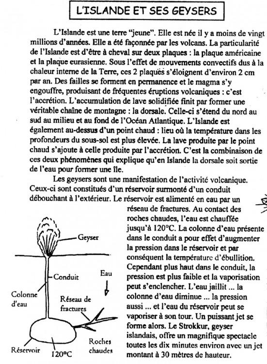

pegasus Posté(e) 9 mars 2007 Signaler Posté(e) 9 mars 2007 Tiens, voici quelques trucs qui pourrait peut-être t'intéresser. Par contre, c'est centré sur l'Islande... Désolé, je n'ai pas d'exemplaire en français car moi je travail en anglais... Iceland is a relatively young land which started to be formed less than 20 million years ago. It is nothing in comparison to the Earth which was born 4.5 billion years ago. At the origin, it is made of volcanoes which went up the ocean and which, after a series of eruptions, ended up by shaping this island whose landscapes are unique in the world!!! Indeed, Iceland abounds in sumptuous landscapes resulting from the battle the forces of nature fight against water, ice and fire… The characteristics of Iceland are that it is an island situated halfway between two plates, on one side the American plate and on the other side the Eurasian plate. These two plates deviate. This phenomenon is completely normal because the Earth is covered by plates which coincide perfectly between them. These plates move because of the intense heat which reigns under ground. Due to the extreme temperatures, masses of rock go up towards surface. During this increase of temperature, these rocks cool down, consequently, to the approach of the earth's crust, the rocks, having become denser go back towards the core of the Earth. These movements, called movements of convection, move like a conveyor belt involving the plates which are above. Consequently, some draw aside (movement of divergence), others overlap (movement of convergence), others collide and creating mountain range such as the Andes cordillera. Iceland is precisely at the border of two plates which deviate, on the one hand, the American plate and on the other hand, the Eurasian plate. The border between America and Europe is not clear; it corresponds to a series of parallel cracks such as in Thingvellir. These cracks, which are formed because of the thinness of the earth's crust at these places, have been forming for millions of year. At the bottom of these faults, one can't distinguish the “depths” from the Earth because they are filled with rock. Indeed, as soon as it opens, the earth's crust is full again. Because of the thinness of the crust on the level of the junction of the plates, they exert a lower pressure on the magma tic rocks. Consequently, these rocks are liquefied and engulfed in the faults to fill them. This phenomenon is called “accretion” that is why even if the plates can deviate, no “pit” is formed between the two plates. On the contrary, on the level of this junction, the earth's crust tearing regularly, the lava which spouts out in the form of volcanic eruptions accumulates and ends up forming a mountain range which is called a dorsal. We can thus observe at the Atlantic ocean bed, between the American and the Eurasian plates and in the prolongation between the South American plate and the African plate, an immense mountain chain : the mid - Atlantic dorsal which is 15.000 km - long and which emerges on the level of Iceland. On the level of Thingvellir, we can observe an immense 30 km broad and it is in this fault called rift that the cracks resulting from the gap between the two plates are formed. Iceland is thus divided into two by this rift and grows of 2 cm per year. Consequently, it is the entire Atlantic Ocean which widens. At the ocean bed at the level of the dorsal, the volcanic activity is intense. For example, we can observe seism and hot water springs like black smokers. Iceland emerges from the ocean at this place because two forms of volcanism combine itself. A volcanism related to the formation of the dorsal, another related to the presence of a phenomenon called hotspot. Indeed, under ground the temperature is, in some areas, higher than elsewhere. The rocks which undergo these extreme temperatures, become less dense than the surrounding matter, consequently, they go up towards surface forming a plume from which the head comes and “crushes” itself against the earth's crust, the temperature is so high that its flux acts like a genuine blowtorch which ends up by piercing the crust and enables lava to spout out. In the North Atlantic, the hotspot emerges exactly on the level of Iceland between the two plates. The produced lava by the hotspot thus adds up to that resulting from accretion volcanism. For this reason the dorsal emerges on the level of Iceland by forming an island. In 1783, in Laki, an enormous 25 km length crack opened and more than 100 volcanic mouths were formed at this place. This enormous eruption lasted 9 months and more than 10 km3 of lava spread in the plain on a surface of 550 km ² to the sea (~ 5 times the surface of Paris). It was the most important lava flow that Man had known. It was accompanied by an enormous emission of gas and ashes which contaminated most of the pastures of the island and decimated part of livestock. A catastrophic famine followed causing the death of almost a quarter of the population of this era. This eruption had consequences until Europe. Indeed, the produced gas cloud at the time of this eruption went up to 10 km of altitude and, because of displacements of masses of air on a large scale, covered all Western Europe. In France for example, the climatic consequences were catastrophic because they caused a consequent cooling of a few degrees, the weather remained cold until the end of June, which caused disastrous harvests this year and thus led to famines, 5 years before the French revolution… In Iceland, it's the landscape which undergoes a revolution with each eruption because there exist an average of one eruption every four years such as the one of Krafla in 1984, one of the most active volcano of the island (which comprises 200 of them). The latter is very dangerous since it can awake at any moment… But Iceland comprises great uninhabited spaces, then even if the eruption is impressive, it rarely threatens its population. However, it occurred once, on the night of January 23, 1973, on the only inhabited island of the Vestmann islands and larger harbour of Iceland, Heimaey. This city was almost completely destroyed by the lava flow and projections of ashes. The 5000 inhabitants had to be evacuated in catastrophe, all seemed lost. But it was without taking into account the ingeniousness of the Icelanders. Indeed, they had the idea to pump sea water and to project it on the lava in order to cool it down. Thanks to that, the city was partly saved. The eruption had considerably increased the island and the harbour was much improved and protected from the storms. Another eruption is still famous. It is the one which happened on November 14, 1963 because it gave rise to a new island. As for any other Icelandic eruption, this one was due to the alliance of the dorsal and the hotspot. This piece of ground was baptized: Surtsey. Today, Surtsey is the youngest island of our planet. Surtsey is protected and only the scientists are authorized to go there. Over there, they can discover how the animal and vegetable lives appear on a virgin land. In Iceland, the Vatnajökull glacier is the largest glacier of Europe. Indeed, larger than Corsica, it occupies 10% of the Icelandic territory with its 8000 km ². In some areas, its thickness can reach 1000 metres. Under this enormous glacier, there are many volcanoes, of which 3 are very active. On September 30, 1996, the powerful eruption of the Grimsvötn volcano began under the glacier. Released heat dissolved the ice and water, then gigantic steam plumes rose up to several thousands metres of altitude accompanied by an immense sheaf of ashes. The released heat made the ice melt. Then, thousands of cubic meters of water disappeared under the glacier. After fifteen days of eruptions, the volcano fell asleep again. All seemed over but 2 weeks later, at the foot of the glacier, mud torrents spouted out in the plain. A tidal wave flooded many square kilometres for 2 days. Its flow even reached 45.000 cubic metres per second. Under the glacier, there is a magma tic room with an old chimney leading to a caldera. A caldera is a kind of basin formed by the depression of an old crater. Partly filled by ice, this caldera also contains water. Before the eruption, the displacement of the plates had involved the formation of new faults which allowed the lava of the magma tic room to go up by taking one of these new passages located upstream of the caldera and to spout out under the ice. Under the effect of heat, the ice melt and the water resulting from this cast iron filled the caldera located downstream. Thus while this caldera was being filled, a depression formed at the level of the eruption. After a few days of activity, the lava succeeded in piercing the ice. A gigantic amount of ash and steam, plumes of smoke rose in the Icelandic sky. Then the eruption ceased. However, the temperature being still very high at the top of the crater, the ice went on melting and running out in the caldera. The water of this caldera undergoing the enormous pressure of its dome of ice, ran out under the glacier by raising the ice thanks to this dome acting like a genuine piston. Then, all the water was driven outside causing a gigantic tidal wave called Joküllum (glacier which runs) by the Icelanders. Today, a new jökullum is feared under Myrdalsjökull because Hekla awoke 3 years ago. At the foot of this glacier the small village of Vik shelters 500 inhabitants. At the moment, it is the most controlled zone of Iceland. When water and volcanism “mix” they give out curious phenomena such as fumaroles, hot and sulphurous gases which escape from the ground such as in Krysuvik. There is also water and mud pools which spout out and bubble at average temperatures of 80 or 100 °C. All these phenomena are due to the fact of the gap between the plates in Iceland. Indeed, because of this phenomenon, the earth's crust is not very thick and the magma is only 2 or 3 km deep. We can also observe geysers such as on the site of Geysir which gave its name to all the geysers of the whole world. A geyser appears as a surmounted underground tank of a long conduit which emerges outside. It is fed by a whole network of fractures in which circulates rainwater which, in contact with the very hot rocks, reached very high temperatures, up to 120 °C. Usually, water, at this temperature, vaporizes at the atmospheric pressure but at the bottom of the tank, the pressure is much larger because of the water column which thus prevents water from vaporizing. The pressure not being uniform, the more it goes up in the conduit, the weaker the pressure is. Consequently, in the middle of the conduit, small bubbles are formed and go up onto the surface by evacuating little water. Consequently, the water column being less important and thus the lower the pressure is , the water contained at the bottom of its tank can vaporize. Bubbles go up on the surface by dragging with them the water contained in the conduit which spouts out in a powerful steam and water jet. Citer

jess Posté(e) 9 mars 2007 Auteur Signaler Posté(e) 9 mars 2007 vous me sauvez la vie lol parce que j'avais du mal a cerner le probleme comment de grande plaque tectonique donne l'apparitio a de "petit" geyser je comprend mieux et aussi chque occasion est a prendre pour parfaire son anglais! MERCI beaucoup Citer

jess Posté(e) 9 mars 2007 Auteur Signaler Posté(e) 9 mars 2007 donc en gros si j'ai bien compris grace aux fissures faites par des plaques divergentes et grace a la propriété des roches peu friable on forma un conduit pour le geyser? Citer
